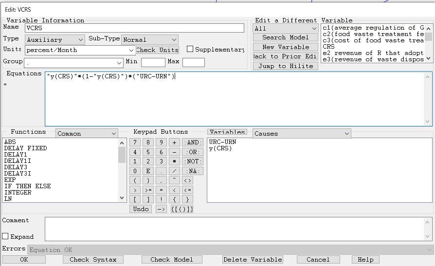

replicator dynamic equation:dy/dt=y(1-y)(URC-URN)
The left hand:percent/Month
The right hand:CNY

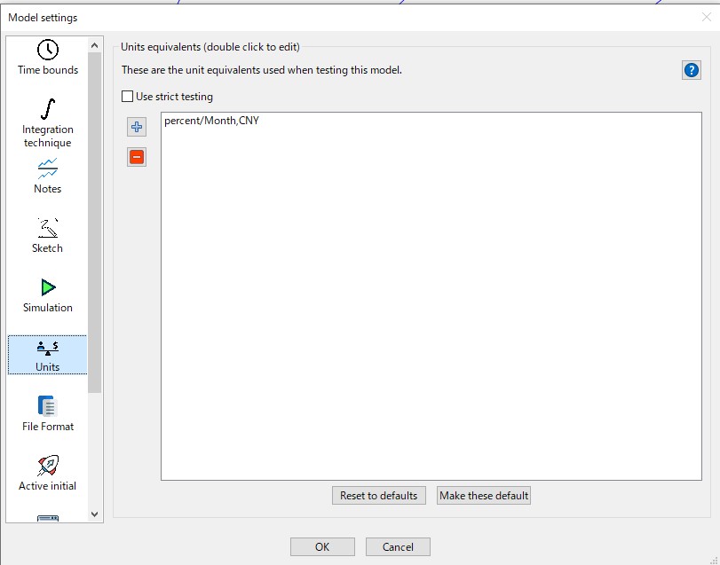

Although Units equivalents [percent/Month,CNY] were set, this problem still exist.
Thank you for your answer :D

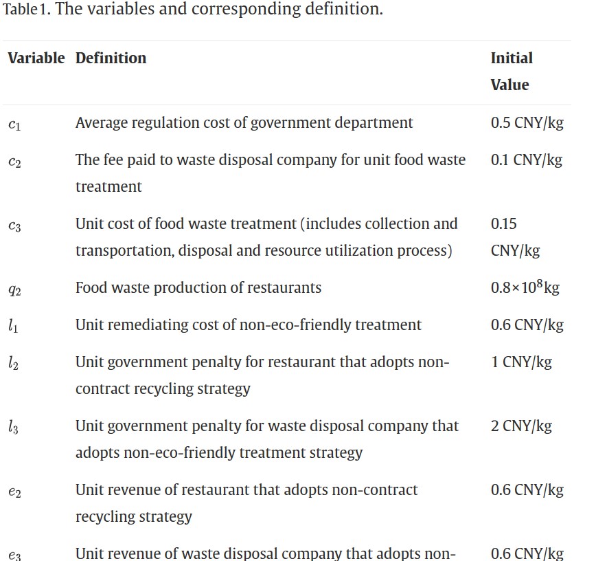

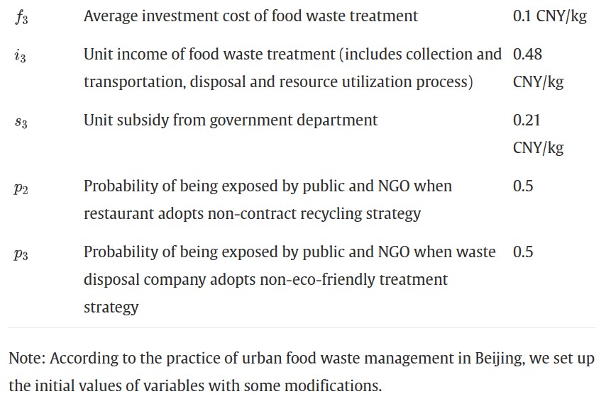

The unit "CNY" is the chinese currency unit.

First of all, remove the units equivalence "percent/Month,CNY". CNY is currency, percent/month is definitely not. You use units equiveillances for things like "month,months" or "person,persons,people,human".
Looking at your model, start by putting in units for all of the parameters. These units should match reality, if something is an interest rate, it should be something like percent/year or percent/month etc.
I've got no idea what all the parameters refer to in this model so cannot really offer any more advice.

I want to set the rate(variable)'s unit in eqution: dx/dt=x'(t)=a×x(t),a is const.
But, units do not match(left and right hand).
x(t) represent the probability of selecting one strategy, i set the unit: Dmnl,
but the unit of [dx/dt] must be the 1/Month(or other time type), so i can not match the units between the 2 sides.
Could I explain my question clearly?
Wish for your help.
Thx...

The unitrate was set as Tolerances for Arithmetic Sequences, i.e. dx/dt=Δx, the unit of left is 1/time, but the unit of right is 1.
How can I match the units?
Thx

Fist thing, δx should have units of DMNL/month as it's a rate of change.
I cannot really offer any more assistance as the model is not documented, I've got no idea what things like "L1" are (or if the units for it are even correct).
